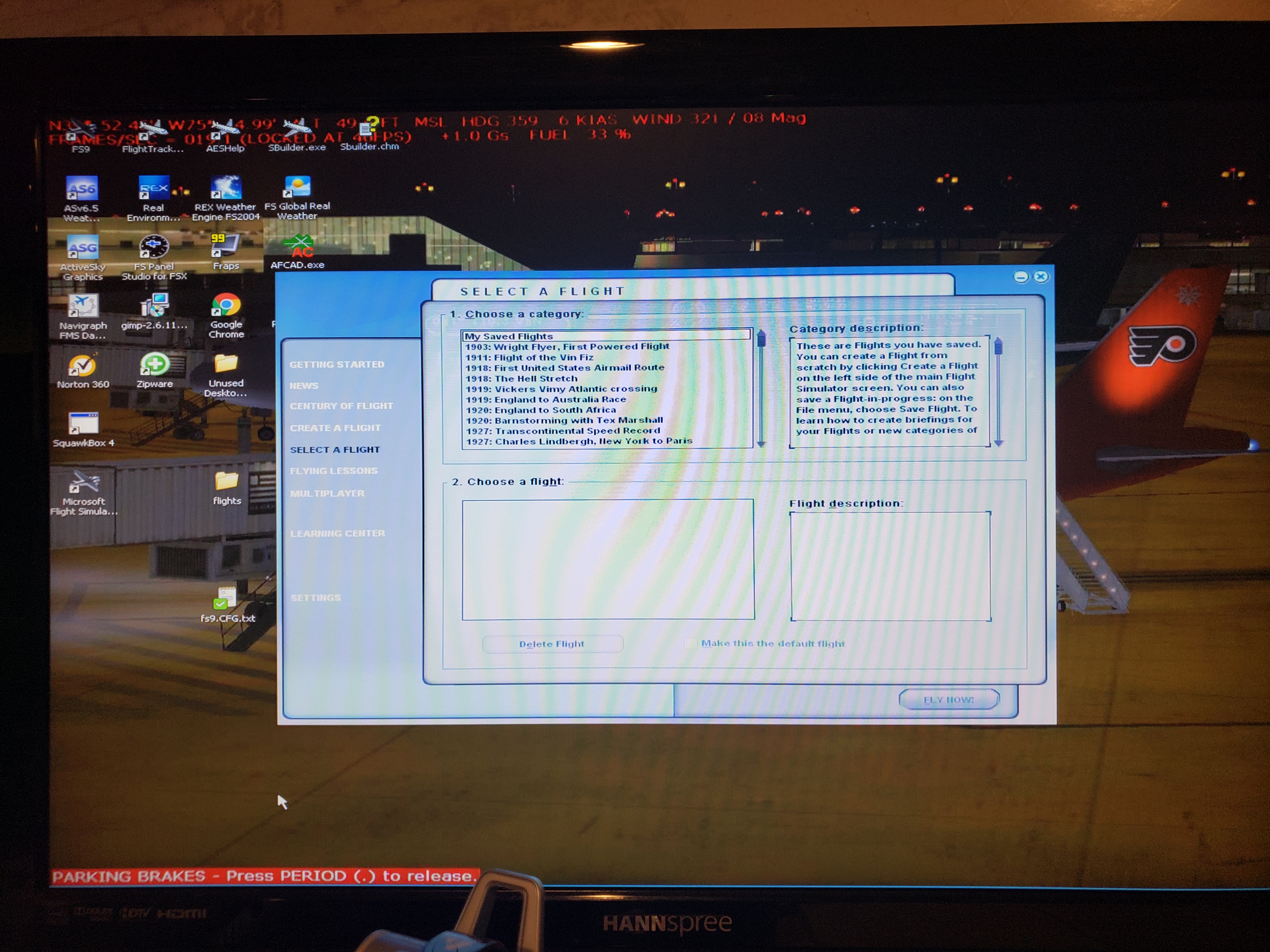

FS9 splash screen comes on program opens to my saved flights page then immediately closes.
My computer was saying c: drive was low on virtual memory and disc space only 30mb left out of 74gb.
I deleted some programs that I dont use anymore and moved some stuff from the c: drive to my external Seagate drive which cleared up about 26gb on the c: drive.
I tried uninstalling and reinstalling FS9 and it did the same thing. I am looking for fs9.cfg file but I cannot find that anywhere.
Any suggestions other than upgrading???
